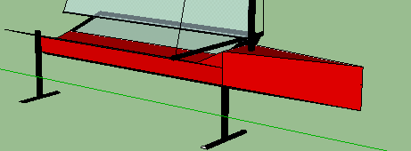

15 years 10 months ago #113550 by jean gui

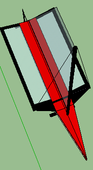

heu j'ai besoin de votre avis:
  • jean gui
15 years 10 months ago #113551 by jean gui
  • jean gui
15 years 10 months ago #113553 by jean gui
  • jean gui
15 years 10 months ago #113554 by jean gui
alors ??? ??? ???

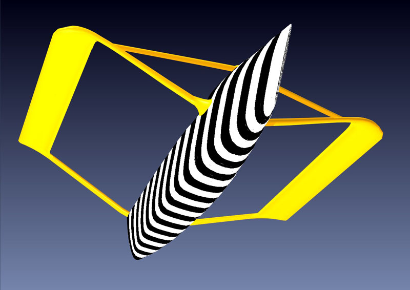

15 years 10 months ago - 15 years 10 months ago #113556 by David Balkwill
Check the dimensions Jean Gui. If the length is right, then the width is much too narrow.
Here's Little Wing in a zebra suit before I started making the mould.
File Attachment:
File Name: IMCA_rules...2005.pdf
File Size:89 KB
Last edit: 15 years 10 months ago by David Balkwill.
  • jean gui
15 years 10 months ago #113557 by jean gui
in french please

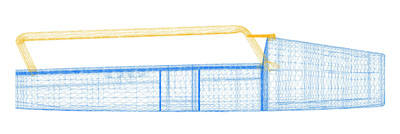

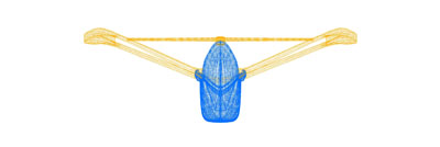

15 years 10 months ago #113560 by David Balkwill
Here's the bow view in wireframe.
15 years 10 months ago #113561 by David Balkwill
Side view. Note that I changed the bow profile later, and cut the transom to make the skirt after I took the hull out of the mould. The other Little Wings have straight bums not like the original sexy one, since imitated by the Mach 2.

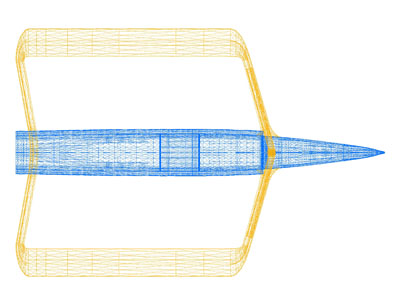

15 years 10 months ago #113562 by David Balkwill
And the plan.

15 years 10 months ago #113563 by jean gui
bon j'ai un petit peu de mal mais je crois que tu veux les dimention:
longueur:3.55M
largeur:1.30M
surface de voile:7.5m²
  • jean gui

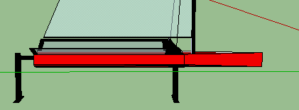

15 years 10 months ago #113565 by jean gui
petite modif de l'avant:
15 years 10 months ago #113566 by YvesC

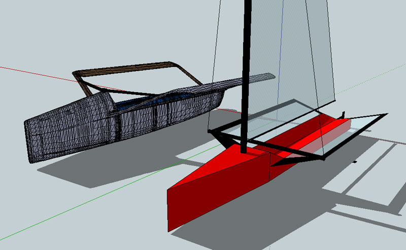

De l'encouragement pour Jean Gui.
Son projet a cote de Little Wing.
