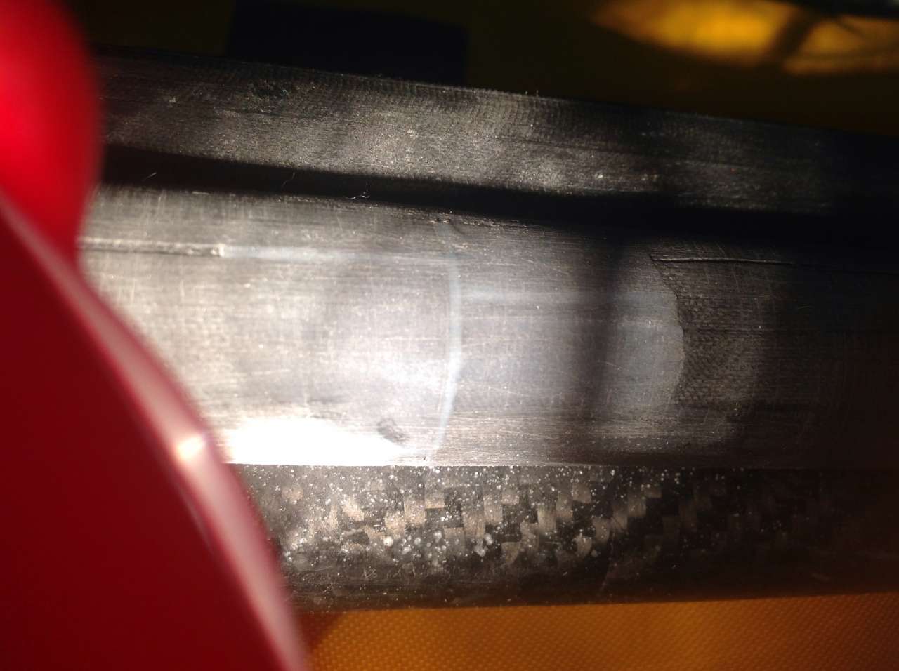

12 years 9 months ago #154531 by lolo
Replied by lolo on topic Re: Réparation stick carbone
Photo de la jonction du stick réparé
