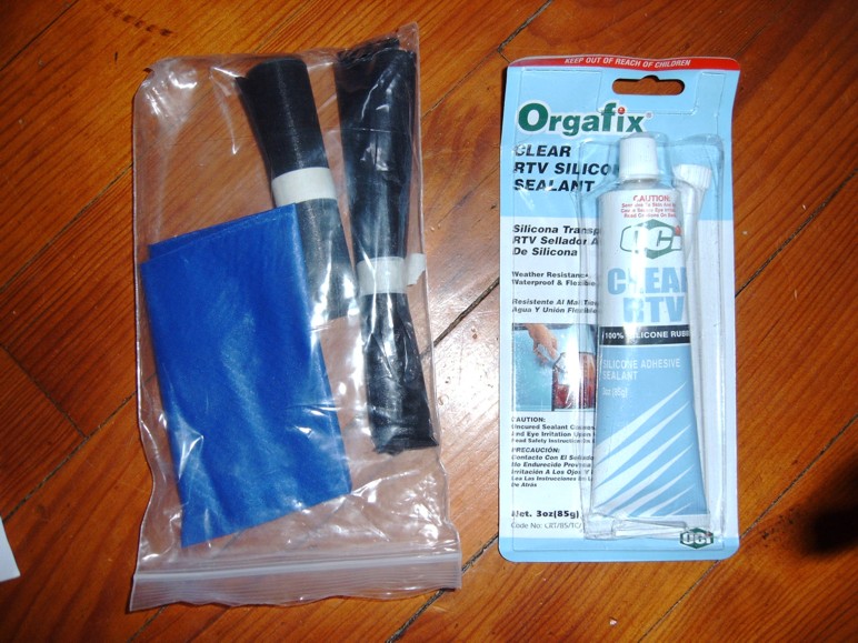

19 years 10 months ago - 12 years 6 months ago #53937 by cadre
Replied by cadre on topic reparation spi silicone
