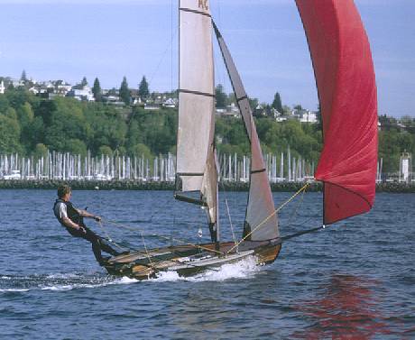

Y-en a des gonflés quand même! trois voiles, la barre et au trap!!!

Pour ceux interesses, la photo est celle d'un Swift solo
www.single-handedskiffs.com/pages/453349/index.htm
et voila ce qu'en dit Julian Bethwaite
Julians review
Comments on Bram's 24 1/2er
Having a jib on a single-hander combined with the main/jib sheeting system keeps the boat balanced across a wide wind range; it also has excellent windward performance. It needs a softer mast to take full advantage of the sheeting feature, but even as it is rigged now, when bearing away in a puff the boat responds immediately and impressively! Most single-handers can't respond like this.
A second advantage to sloop-rigging is that it lowers the rig plan compared with cat-rigging. This allows the 24 1/2 er to perform well without wings because the rig aspect is more moderate (compared with a boat having racks and a cat rig setup) therefore the boat is easier to sail through gust/lull wind variations. You won't get dumped in the water when the wind drops and it is easier to respond to sudden wind changes. The moderate sail plan has low drag and goes upwind surprisingly fast. I easily stayed in front of a 5o5 going to weather.
The spinnaker is big-possibly too big-but it works and is very manageable. It is possible to sail low and fast downwind.
Some other pluses:
1. Gunwale angles set up well so no need for foot loops.
2. Very positive steering
3. High boom so easy to tack
4. Main sheet, effectively 1:1 so easy and simple trim
5. Great feeling going upwind
6. Feels comfortable to get low on the wire.
7. No vices in bearing away.
Some minuses:
1. Hull a bit full 3ft back from bow
2. Top of mast too stiff
3. Main sheet is stiff
4. Footrails not high enough
In conclusion, this is a very good design! This boat would be great for sailing by yourself whenever you want. It gives good skiff feel and would teach great boat handling.
I commend the designer/builder.

Bin, on est toujours comme ça en sortie solo sur le 29er...
Mais c'est une bien jolie bête en bois maaaaaagnifique. On revendrait presque le nôtre. :)

Bin ca alors!!!! C'est la qu'j'navigue. Le bateau de Bram est "joli" ... Un peut lourd sans doute. La photo est prise a Seattle ... Y'en a 3 sur les pontons a Shilshole. Y'a plein d'chose a redire sur la form de la coque ... Mais bon, son cannote marche bien, inspire du forty. Il devrait en sortir une petite disaine a Seattle. La coque est en bois latte epoxy. Ca donne un bateau plus rigide/leger qu'en polyester. J'pense essayer son engin d'ici la fin d'l'ete.

est ce que tu peux dégoter les mensurations du boat en question? poids, surface GV construction etc?
c'est un bateau que je trouve intéressant. merci françois pour cette foto d'un bateau inconnu.
