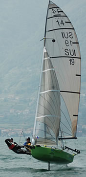

19 years 2 months ago #46993 by pchanez
J'ai demande l'avis de Martin Blum (Moth, 18, ...) et voila sa reponse
Hi Patrick!
Good to hear from you! On the 14s, about 4 boats in AUS and about 2-3 boats in UK are experimenting with foils. Indeed, Emmett Lazich had put his old Xerox 18 on Foils, too.
It is working. No problem. I like the old sentence of Bölkow "flying is only a question of motor power".
That in fact is the foiling topic. We do have limited motor power. To go ahead, and not only up, we need all the power, because we want to go fast. To be the fastest, the power to lift should be reduced to NOTHING.
Additionally, if there are manouvers etc. the thing has to last and has t not to break down the boat in low wind conditions.
Each of the parameters above is growing with additional load. So, load is the limiting variable.
For me, it is sure, that here the same development will start like on the windsurfers: Other vehicles are able to sail, too. But noone be faster than one.
There is no question, that a foil may accelerate a 14 downwind. Maybe in
2-3 years, Upwind, too. (I am thinking of racing, not of cruising).
But to be fastest, you have to be one person with strictly limited mass around you.

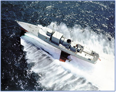

19 years 2 months ago #47030 by Patch
on remarque quand même que ce sont réellements des essais qui pour l'instant ont l'air d'être plus impressionnant qu'ésthétique... mais le potentiel d'augmenter nos vitesses sur l'eau est là!!!
En parlant de moteur en voila un de ces oiseaux mais celui là dévellopé par l'armée et qui pollue en plus.... Donc bravo à ces passionnés qui on la persévenrence et la motivation de les dévellopés en plus avec des énergies propres!!!

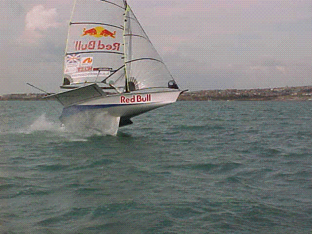

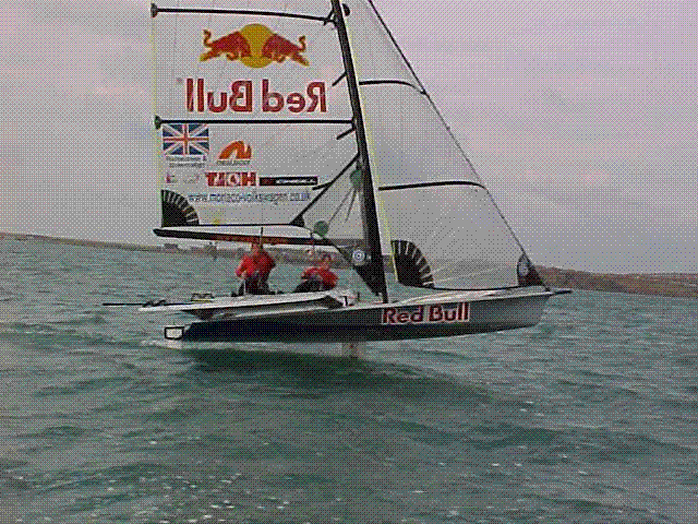

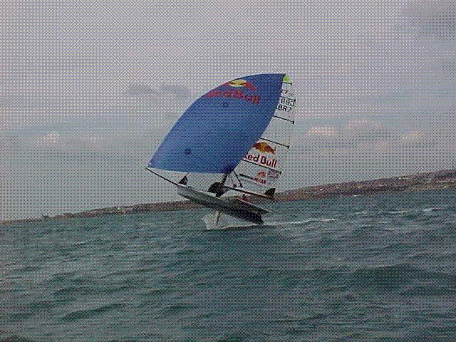

19 years 2 months ago #47308 by motivex
Voilà ,3 photos retrouvés dans mon disque dur...
19 years 2 months ago #47309 by motivex
Et une autre.
19 years 2 months ago #47316 by Nico de Saint Malo
Beuax départs incontrôlées ! Ca arrive beaucoup quand on ne régule pas la hauteur avec le foil de safran.
J'en ai fait beaucoup (trop !) à weston l'autre jour.
Espérons que je controlerai mieux à weymouth ce week end avec mon tout nouveau super mega bon sysytème que j'ai bricolé hier soir. :o
