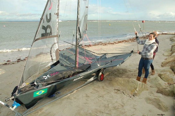

Et le vrai scoop est dans le communiqué de RS plus que dans les photos...
RS900 – women’s Olympic skiff contender – latest photos and update
Testing of the production specification RS900, RS Sailing’s contender for selection as the new women’s Olympic skiff, is underway.
“We believe that a new generation of elite skiff sailors deserve a purpose designed boat that will excel in the role and stand the test of time” says RS managing director, Martin Wadhams. ”After several changes to the women’s classes over recent Olympic cycles, the last thing anyone wants is another short term measure. We began the process several years ago believing that the RS800 could be modified to become the women’s skiff, but quickly realised that although it was arguably the most suited of the then current bunch, it would never be perfect for Olympic women. So our own RS team of Alex Southon and Nick Peters has worked with Phil Morrison to start from scratch and design the RS900 without compromise.”
The RS900 hull is shorter, narrower and has lower freeboard – smaller all round to suit light female teams. The reduced surface area allows a corresponding weight reduction whilst using a similar long lasting, epoxy foam sandwich construction system to the 800.
Fully integrated wide, solid wings and a smooth run-through deck on the RS900 facilitate athletic sailing. RS900 sailors will use techniques matched to those of the 49er men, allowing shared training in many regions, especially helpful for smaller sailing nations. As you can see from the photos, the wings fit smoothly into the hull providing arguably the most flowing platform of any skiff, plus structural integrity and seriously good looks.
Structural engineering has played a major part in the design development of the RS900. RS technical director Alex Southon has significant, hard-won, volume production experience and he has enlisted input from world class composite engineering experts in the USA on this project to help him create a boat that is not only strong and long lasting, but also efficient to build. This will keep costs low for a skiff of this type and the RS900’s price will in line with a competitive 470 rather than the similarly high performance 49er!
The rig is matched to wide leverage to produce spectacular performance whilst suiting the110 -130kg crew weight range specified by ISAF. The jib is tacked onto the bow, with the forestay attachment point pushed as far forward of the forefoot as possible to give maximum low-down jib area, without excessive hull length and correspondingly reduced responsiveness. The relatively straight mast and square head mainsail follow the latest skiff design trends and, of course, a masthead spinnaker maximises downwind performance.
RS Sailing has the proven ability to produce a large number of epoxy racing dinghies quickly - last year around two hundred RS100s were built and delivered to destinations across the globe within 12 months of launch. Their international dealer network provides back-up support with parts and sails.
Final testing of RS900 will continue over the coming months in the run up to ISAF’s evaluation trials which are expected to be held in March 2012, although as Alex Southon says “We’re talking about details now from a development perspective. The 900 works and all the sailors who’ve been in it so far are really excited – so we’ll just keep tweaking the rig and getting miles under the hull until we have to stop!”

Oui :
- coque plus courte que le RS 800 : c'était son défaut par rapport au poids cible des équipages. Je pense qu'il à perdu 10-15 cm et doit faire la taille du Aura tout en restant plus grand que le Rebell et que le 29erXX.
-Coque plus étroite et moins de franc-bord : j'imagine pour rendre le bateau plus technique.
Pour ce qui de la construction, ils ont l'air d'avoir bien réfléchi pour garder des prix pas trop élevés : quand on discute avec des gens bien au courant des dernières tendances de l'ISAF il est semble impératif de limiter les coûts au maximum et d'ouvrir à un maximum de nations. Cela a son importance surtout par rapport au 29er XX qui bénéficie de la continuité avec le 29er Std.
Dans tous les cas, ils ont bien trompé leur monde. Longue période de test sur le couple mât voile et ergonomie avec un RS 800 modifié pour finalement venir avec une coque entièrement nouvelle. Difficile de leur dire que le handicap du projet RS900 c'était la carène trop sage du 800.
En même temps, le fait d'avoir développé une nouvelle carène prouve qu'ils y croient. A Athènes l'année dernière, Martin Wadhams m'avait dit que RS irait au bout du projet si et seulement s'ils avaient une chance de l'emporter. Ils ont dû avoir de nouveaux éléments, notamment sur ce qui se murmure à savoir que Bethwaite ne serait plus forcément en odeur de sainteté à l'ISAF...
Soutien de l'Angleterre, d'un certain nombre de pays nordiques j'imagine (où les Tera, Feva etc sont bien implantés) et d'autres. La France pour le moment est avec d'autres plutôt sur le XX puisqu'elle a essayé de faire passer une soumission en novembre pour choisir le XX tout de suite...

J'ai du mal à voir sur les photos comment le bateau est conçu au niveau des échelles : sont-elles fixes ou amovibles ? Si fixes, quelle sera la largeur du bateau par rapport à la problématique du stockage, transport routier et où container ?
J'ai l'impression que le tangon est relativement long : tant mieux, ça va décoller sous spi et cela est un point positif par rapport au 49er.
Après aucune indication s'ils vont oser faire un mât en deux parties ; ce n'est pas dnas le cahier des charges de l'ISAF concernant le skiff féminin mais cela l'est dans le cahier des charges du catamaran mixte. Le 29er xx a cet avantage.
Jolie bôme carbone : le même que sur le RS100...
J'irais bien faire un tour du côté de Santander en mars moi... ;D

D'après le texte anglais, les ailes sont intégrées et moulées avec la coque. C'est sûrement la meilleure solution sur l'eau et la plus mauvaise à terre.
Je ne suis pas fana des bateaux gris foncé, mais il est moins laid que le premier proto à la déco improbable.
La déco c'est très personnel. ;rolleyes;
Pour les ailes, j'avais aussi compris cela.
Hâte d'avoir la longueur et a largeur du truc.

www.rssailing.com/fleets.asp?fleet=RS900...Details%20and%20Spec
D'autres photos et d'autres infos... Qui relèvent aussi de la profession de foi..
J'ai l'impression qu'ils vont le lancer même s'il n'est pas sélectionné pour les JO. A moins que ce soit ce qu'ils veulent faire croire. On ne sait jamais.
Mât en deux parties : ils franchissent le cap.
Prix : équivalent à celui d'un 470 compétitif... Ouais... difficile à dire parce que des 470 compétitifs tout équipés cela peut valoir assez cher. Peut être pas autant qu'un 49er neuf mais tout de même.
