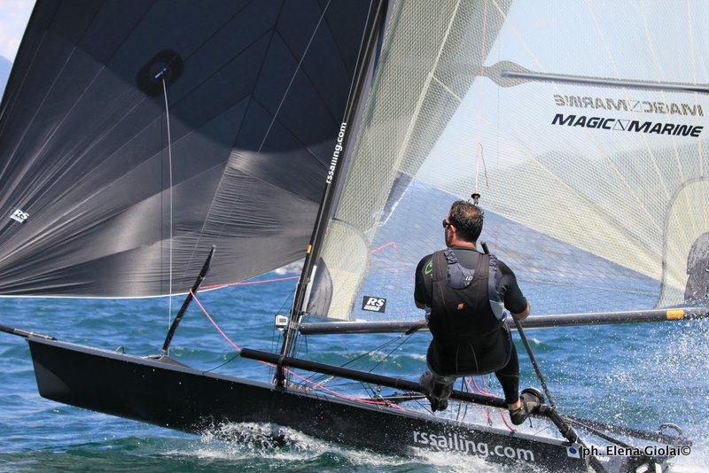

14 years 2 months ago #138844 by antoinetolosane
Replied by antoinetolosane on topic Re: class RS700
Un RS700 Tout noir
Antoine Tolosane
